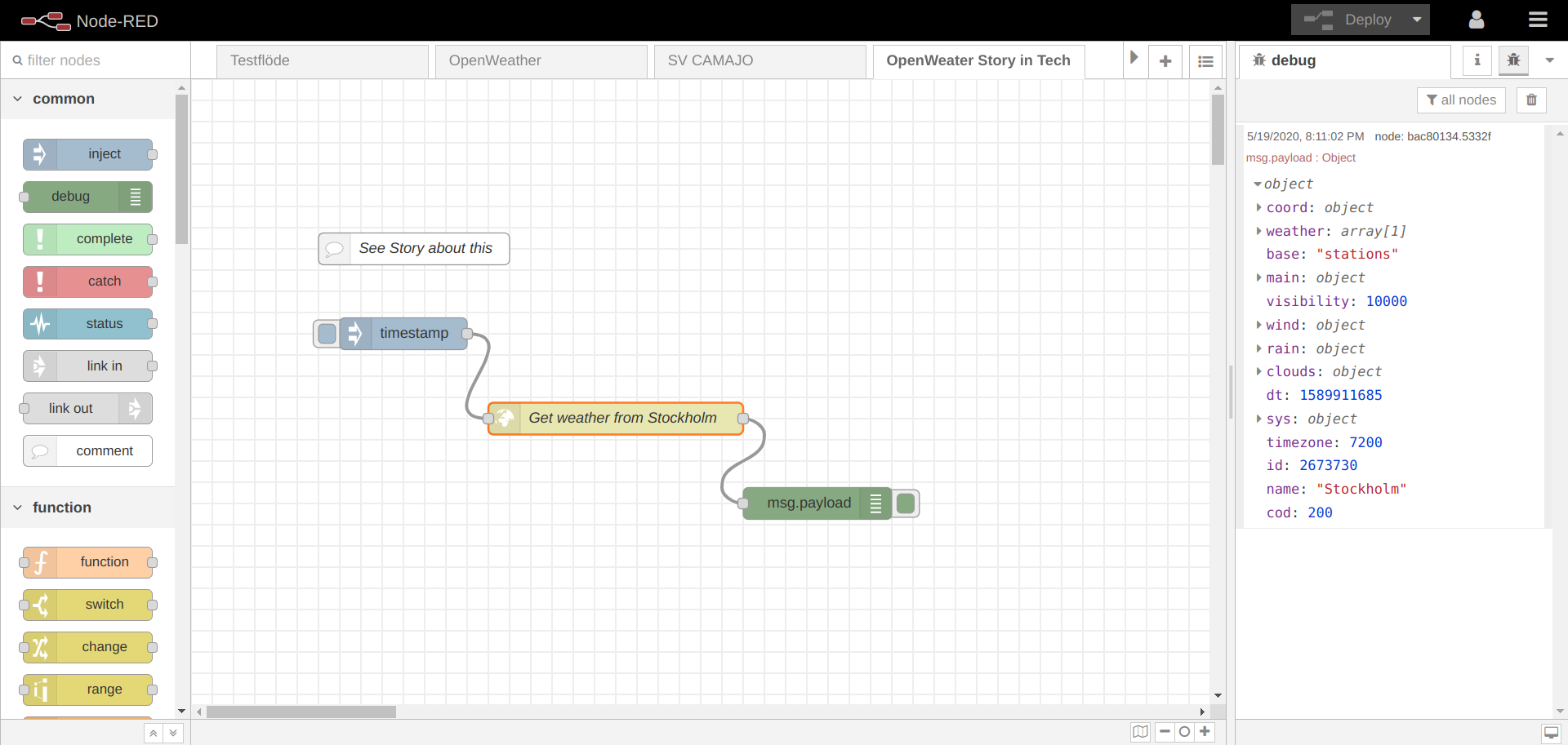

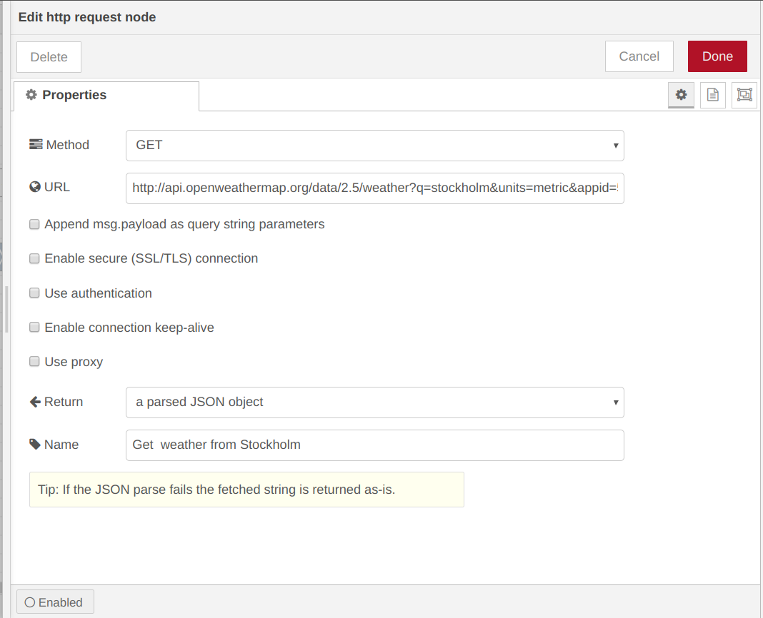

To get data from Open Weather we use the http request node to call the Open Weather API. To get started we connect it to an inject-node and to see the result we connect it to a debug-node. The flow as of now looks like this.
We get the data from this url (remember to add your API Key):
http://api.openweathermap.org/data/2.5/weather?q=stockholm&units=metric&appid=API_KEY_OPENWEATHER
So, the http request node will look like this.
There are other ways to get the weather but that is not in the scope of this story.
Take some time to study the data you get from Open Weather whenever you press the 'Inject' node:

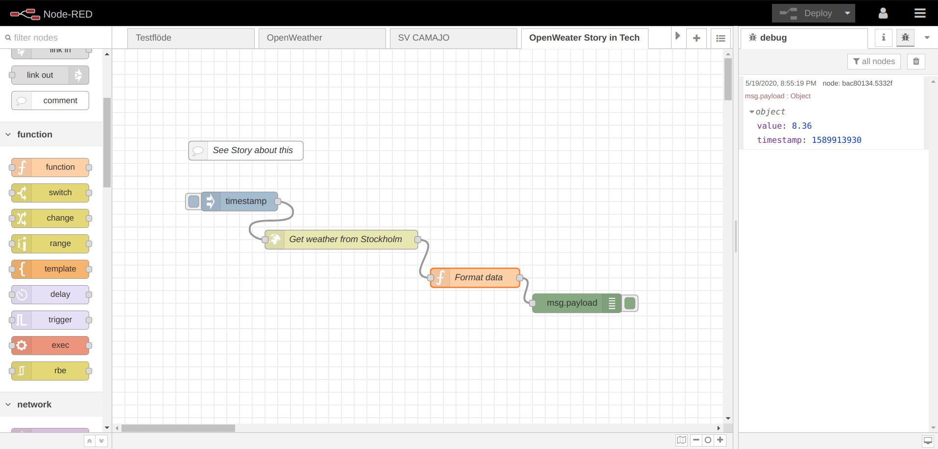

We will only use the temperature for now, but as you can see there are more possibilities left for you to explore.
Pick just the temperature
As you can see the temperature value is in msg.payload.main.temp

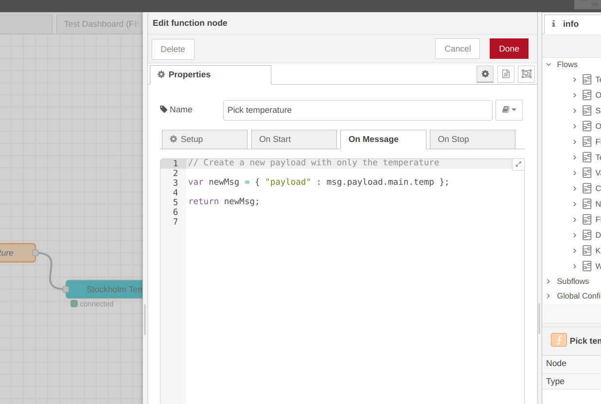

so we have to add a function that builds an object that looks like that. Place a function node at the end of the flow before the debug-node.
Add this code inside the function node.
// Create a new payload with only the temperature
var newMsg = { "payload" : msg.payload.main.temp };
return newMsg;

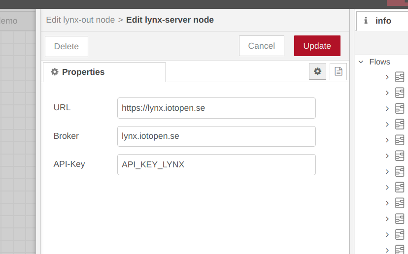

To get the data into Lynx we use a lynx - out
node in Node-RED. First we have to configure it.
- Drag a
lynx - in
node to you workspace. - Double click on it to start its configuration dialog.
- Choose
Add new Lynx-server
and click on the pen. - Enter the following:
URL: https://lynx.iotopen.se
Broker: lynx.iotopen.se
API-Key: API_KEY_LYNX
If you have a custom or on-prem installation the values will ofcourse be different.

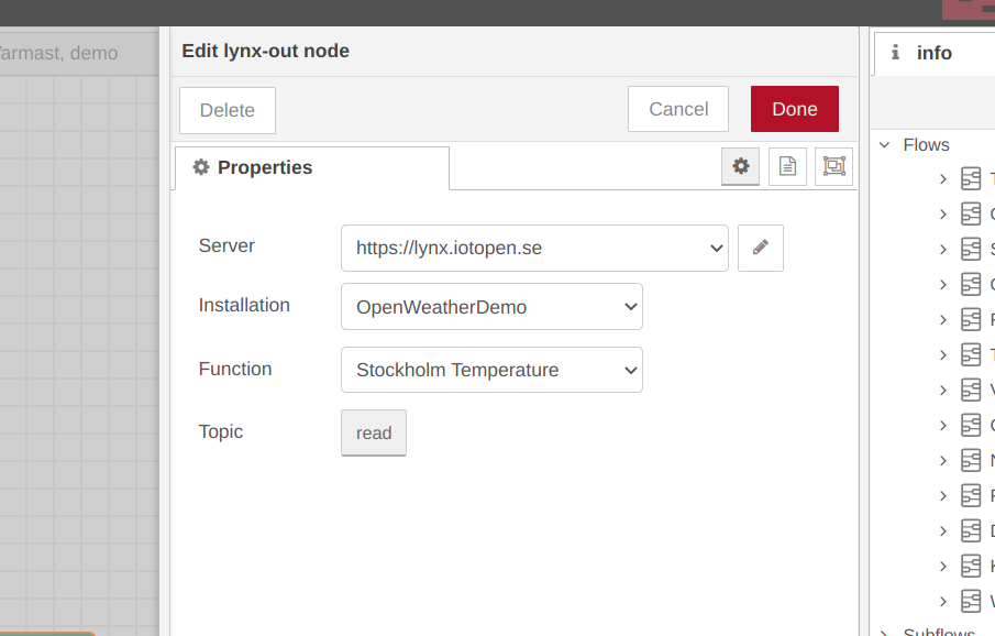

Then chose you installation and the function you created above.
Here follows some dumps on the configuration.

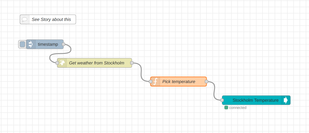

Now connect everything an you should get an updated temperature in Lynx everytime you press the inject node.
Finally, just change the inject-node to inject the weather at some good interval e.g. every five minutes.
