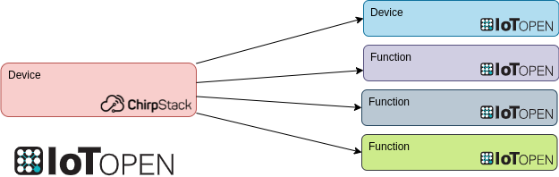

In Chirpstack data are coming from the sensors in payloads. In IoT Open each metric in the payload are represented as a function and the device itself as a device. So one device in Chirpstack is represented by many objects in IoT Open. Se the figure below.

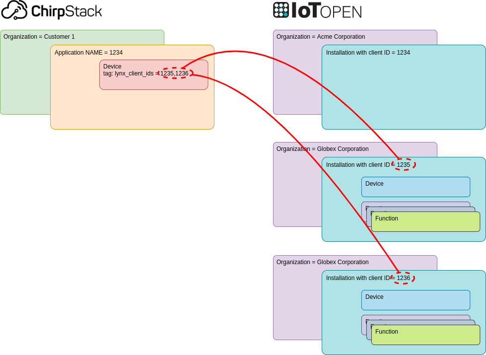

So now we understand how the data objects are related. Let's find our where they'll end up in the organization tree. In IoT Open, every function and device belongs to an Installation. So we need some way to connect the device in Chirpstack to an installation in IoT Open. This can be done in two ways. Via the application name and via tags on the device in Chirpstack. If they are both present the latter has precedence.
Coupling via application name
If the name of the application in Chirpstack is a number, and it correlates to a client-id for an installation in IoT Open then all the devices in that application will produce data to devices and functions in that installation. See the image below:
lynx_client_ids
Coupling via device tag Since we want more flexibility than what the application coupling gives us there is another way to do this. And this is by adding a tag to each device in Chirpstack, containing a list of Client IDs of the installations the data should end up in. This makes it easy to move sensors between installations and also to duplicate the data for several installations. If, for instance, two customers want to share data from the same device. Please observe that when this tag is added the name of the application is ignored. So if you want the device to end up in that installation to you have to add it in the tag too. See the image below.

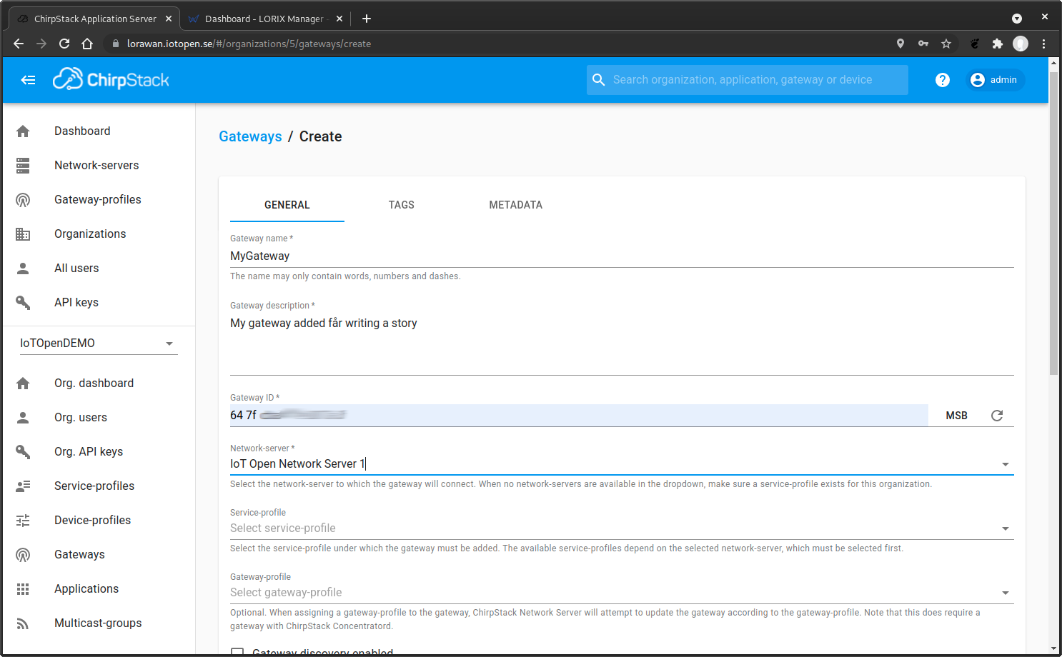

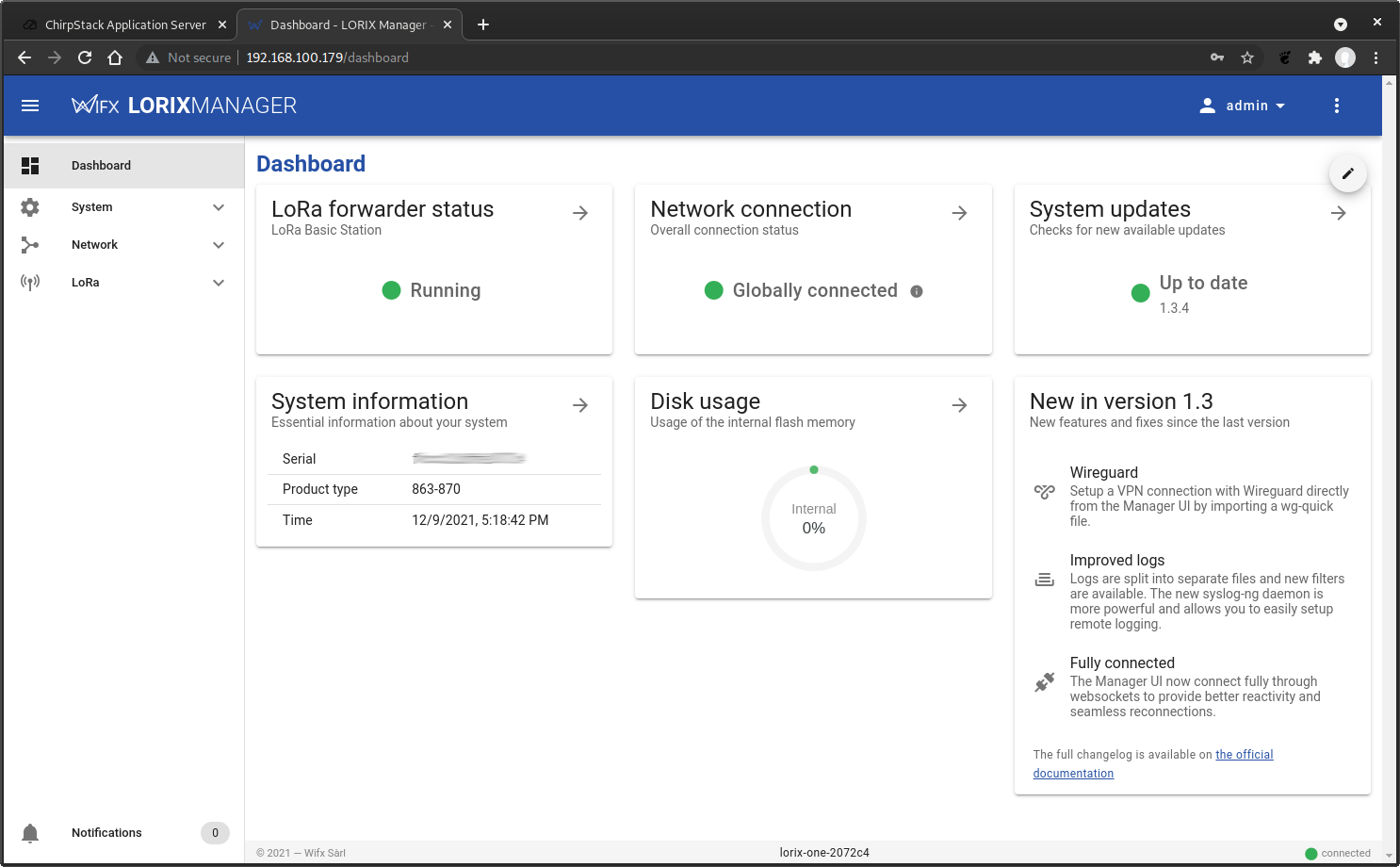

There are not much information that you need to add. From the gateway you need its Gateway ID. This needs to be unique. In some gateways you set this yourself but in most it is created by the gateway. It is usually a serial number or a MAC address. It is possible to get the ID from the gateways interface or in some cases it is written on the case of the gateway.
In my case, a LORIX One gateway, it is in the web interface of the gateway. It is blurred since it might be used to impersonate the gateway.
When you have that string you can easily add the gateway in Chirpstack. The only things you need to add is
- Gateway Name
- Gateway Description
- Gateway ID
- Network server
If you want, it is also good to place it on the map. This will be sent to IoT Open when the sensors send data.

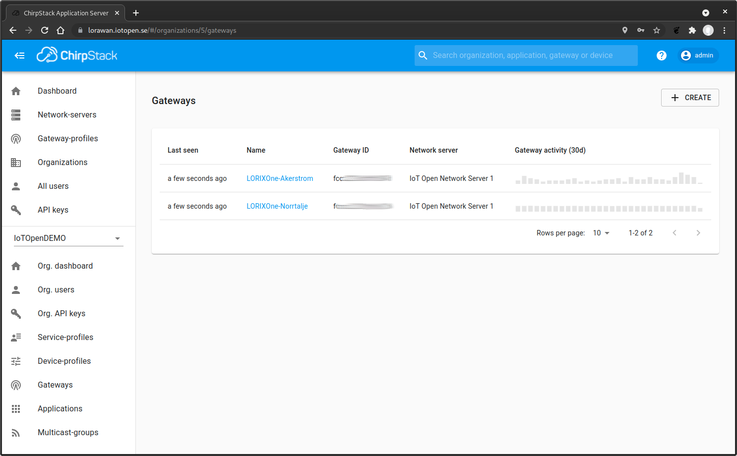

Point your gateway to IoT Open Chirpstack
Once that is done you should be up and running. There are two ways to connect to IoT Open Chirpstack.

I have a LORIX One Gateway, so I read the instructions here on the tech-site. If you have another gateway you should be able to follow the instructions anyway. The parameters to set is the same. If possible I suggest to start with the Semtech UDP since that is the easiest one. You can always change later, even if you have sensors connected.
